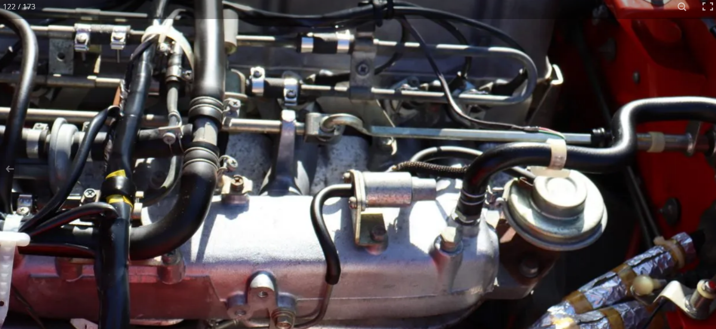

Zed Head it was right there before ours eyes but I didn't see it because I didn't think the N47 had one yet, but I was wrong.
Here's his N47 head with a hole in the passenger's side just like the P90.
My '77 N47 doesn't have this. Must be a ZX thing? And the Maxima head is a MN47.

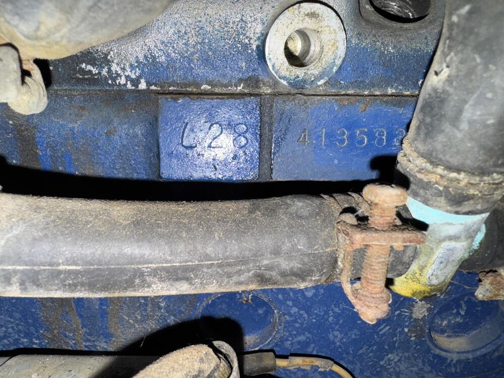

So I had a thought.  Look at the picture with the block number.  Is that an original paint color?  See how it oversprayed onto the head?  If it’s a factory color, I don’t think the head has been replaced. Even the rust bubble line up a bit.
You have a Maxima N47 cylinder head on top of an L28 block. Maxima's had 2.4 liter blocks which would be stamped L24. A Maxima head on a L28 block raises the compression and runs better.
I would guess you have the original block from 1975 which would be an N42 with dished pistons.
That is not the head that came on that L28 block but you do have the parts for a good running car.

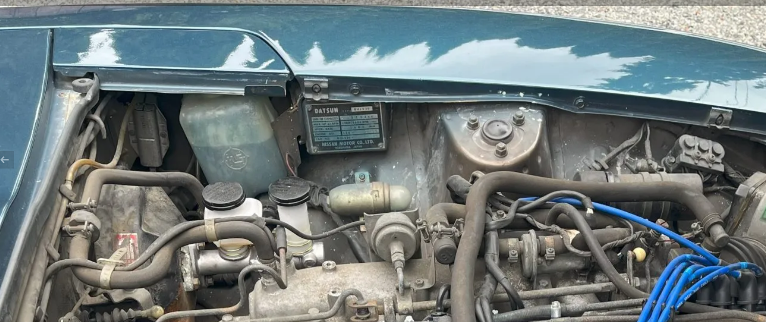

1975 has the engine serial number on the ID tag in the engine bay.  Compare numbers to see if you got just a head swap or a complete engine swap.
The tag is over by the brake master cylinder.

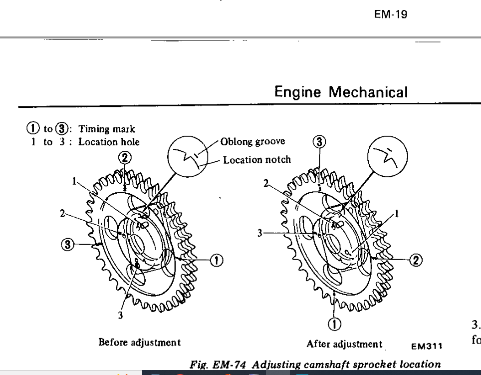

Original Nissan parts have a notch on the timing chain sprocket that will indicate wear.  Rotate the engine to the zero on the damper pulley timing mark and make sure the driver's side of the chain is tight.
