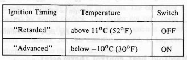

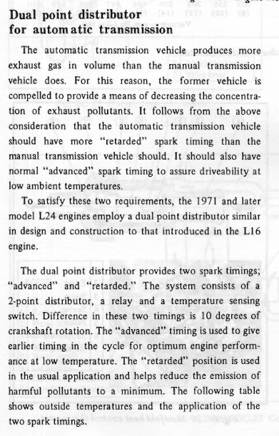

I did some more searching, and @Zed Head looks to be right about the switch being for the dual point distributor. The challenge is that it doesn't show up until the 72 FSM on page EC-11. I found a thread here: https://www.zdriver.com/forums/240z-260z-280z-performance-technical-124/thermal-relay-question-36814/ that shows.
The temperature range and continuity check you did fits with this chart.
And the FSM said it was introduced in 71.
