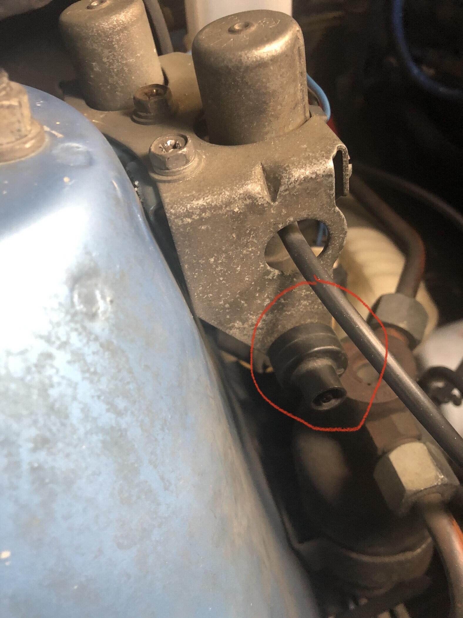

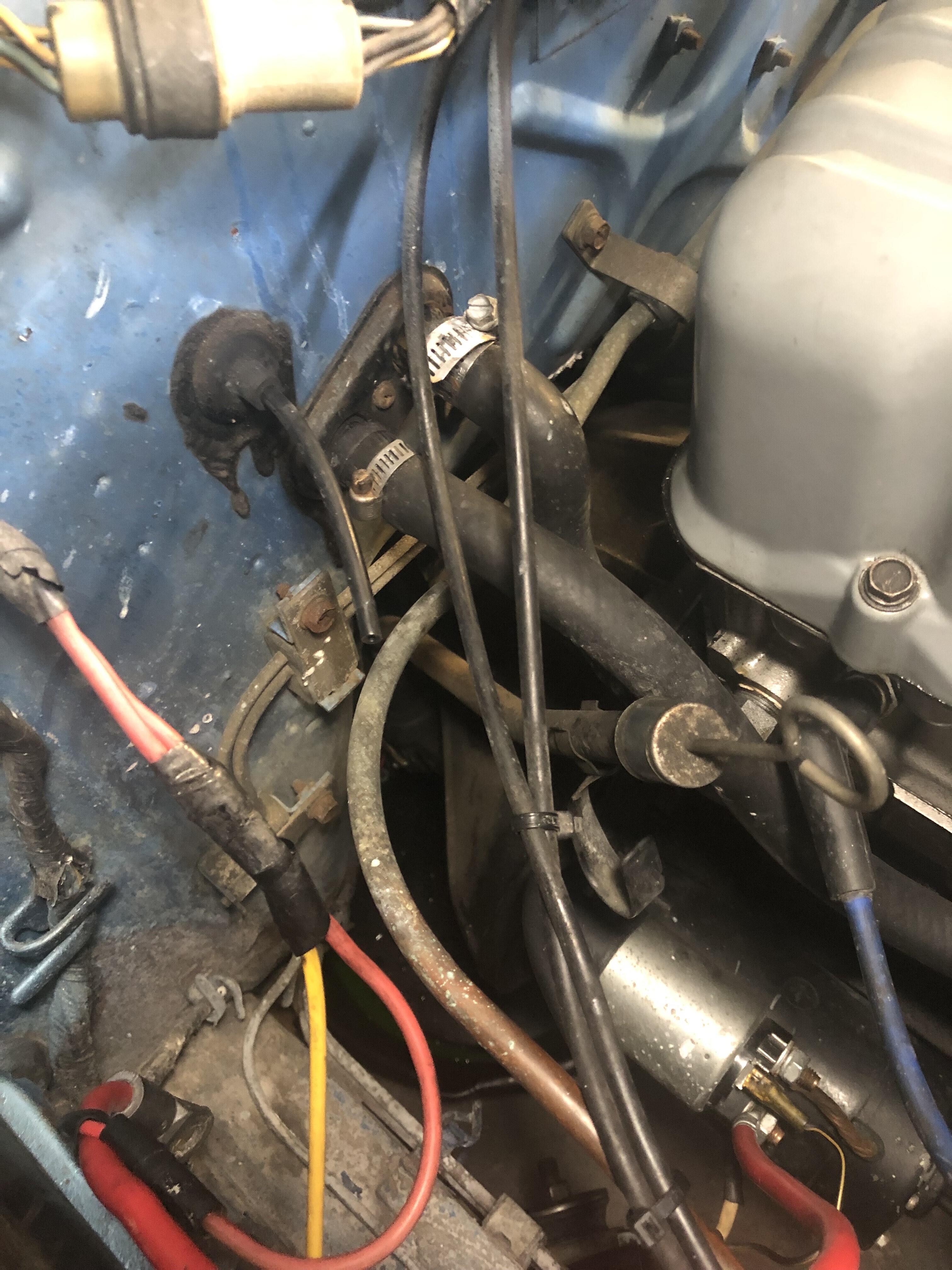

Guys two questions:

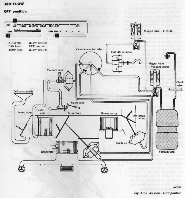

1. in pic#1 the S vacuum line connects to the control assembly inside the dash. There is some sort of a check valve in pic#3 mounted right under the magnetic valve where this line connects per pic#2. I assume it is the smaller end facing towards the firewall where this S line connects too?
The other end bigger end will connect to magnetic end D and M via 3-way line. Is my understanding correct?

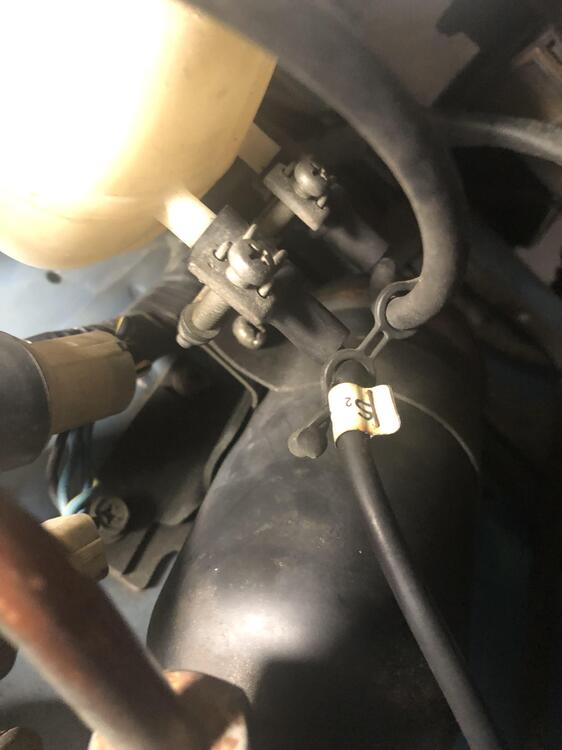

Also, does it matter if the S1 and S2 lines on the vacuum tank are reversed?

Is there some kind of machanism inside this vacuum tank? i assume u mean vacuum tanl S1 and S2 cannot be reversed. I am trying to figure out the orientation of the tank to make sure S1 and S2 are at the right location.
Per my pic, i assume my S2 is connected to S1 on the tank which is wrong correct?
They can be switched.  There's no mechanism inside the tank.
The check valve is important though.  Be careful with the hoses, they are an odd size and tend to split because they're so old.  I spent a lot of time fixing mine, as they kept splitting at the ends, then the check valve went bad.  Overall, it was a pain keeping everything working right.

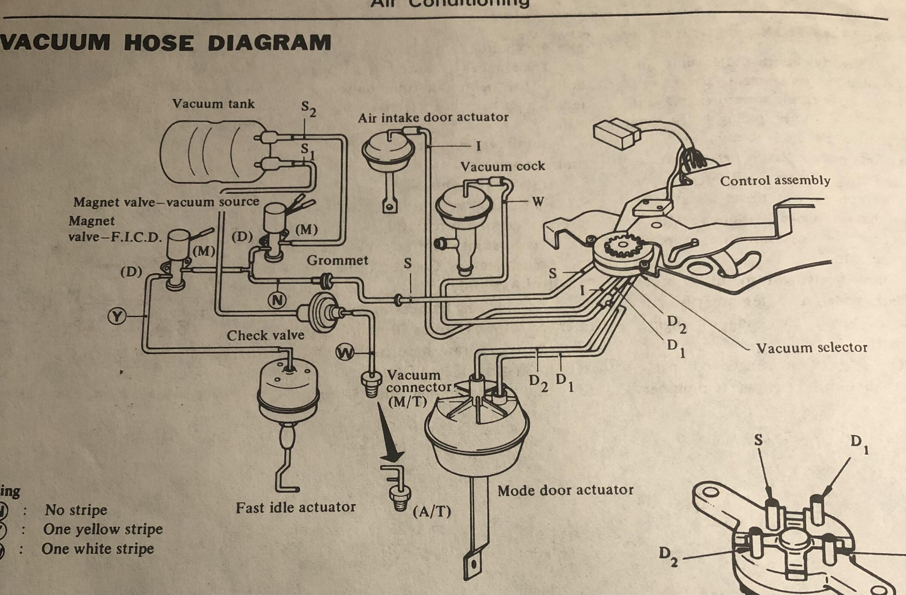

That’s what I was trying to confirm. The check valve pic I posted show the bigger side facing radiator. On the inside is the smaller end. Per FSM pic I assume the bigger end connect to the 3-way connector on the solenoid and smaller goes to S towards the dash through the firewall. Don’t want to connect this one reverse!!! Can someone confirm.
Edited by MH77280Z
The check valve is designed to let air pass out of the bottle and in to the intake manifold, (darn it, I knew I'd do that), but not from the manifold to the bottle.  The hose with the check valve is the one that loops around to the tiny nipple on the top of the manifold.  Suck on the valve to determine which end points toward the manifold.
