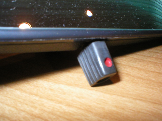

Hello,
I'm the second owner of an early (11/69) 240Z. The car came with a rearview mirror that is a little different from other 240Z mirrors I've seen. This mirror has a red dot on one edge of the day/night twist and nothing on the other edge. The broad sides of the twist have plain, vertical ridges. The other 240Z mirrors I've seen have a picture of a sun on one broad side and a star on the other side.
I've attached a picture of my mirror. Is this a correct early 240Z mirror?
Thanks.

Can't tell if the mirror is original from the picture (too close of a view) but the twist knob is NOT original. As mentioned, it should have SUN on one side and STAR on the other side.
koreavet,
This mirror with the red spot could be the factory fit item for the 2000 GT GTR or a similar car, this item is multi fit and supplied to Nissan for at least four diffrent vehicle types. As you know in early production many things where in short supply a single mirror with a red dot could easily slip quality control if it arrived in a box of 1000.
that one theory
cheers
Steve:classic:
I've got 11/69, HLS30-00238, and that red dot knob is the same one on my car. A quick call to the original owner (I'm the second owner) confirms that the mirror was not switched out.

Hello,
I checked my mirror,(03/70 made)it has star knob.
But I looked at 2 owner's manuals,there is a different description in each one.
#1 (15th Jan 1970 issued) "To rotate the adjustment knob,the red mark for day driving,turn the knob 180 degrees for night driving"
#2 ( 20th Mar 1970 issued) "To rotate the adjustment knob,the
"@"(star)mark for day driving,turn the knob 180 degrees for night
driving"

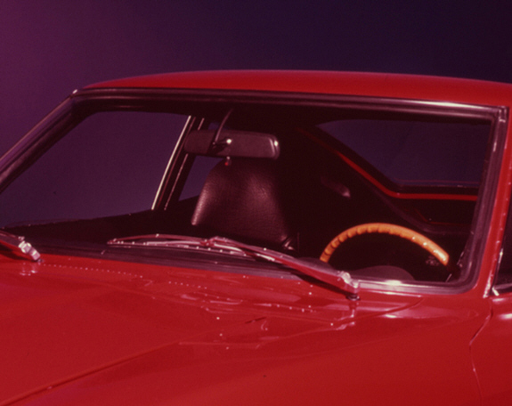

And please look at this carefully,this car is a very very early production 240Z,which showed up in the press kit 22nd Oct 1969
,letter size brochure and canadian mono color brochure.
I can see the red dot on the mirror knob.
kats
Some might not realise that there was yet another version of the earliest interior rear-view mirrors.
This was from the 'no frills' base-level Fairlady Z ( S30-S ) and it had no knob on it at all - it had no 'Night' anti-dazzle position.
This was also seen on the 432R, which shared many of the 'no frills' touches of the S30-S in an attempt to save weight.
*96321-E4100 BACK MIRROR arse'Y - inside ( S30-S & PS30-SB )
( no Anti-Dazzle position )
*96321-E4600 BACK MIRROR arse'Y - inside
*96321-E4601 BACK MIRROR arse'Y - inside
I wonder if the E4600 is the "Red Dot" type and the E4601 is the "Sun & Star" type that very quickly superseded it?
