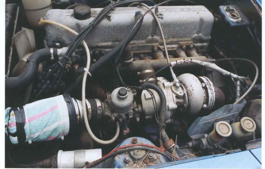

I don't quite understand your second question, so I'll answer it this way. You can't use the fuel return line for feeding a carbarator, looking at your attached photo it looks like the fuel pump has two outlets, so I assume that one is currently blocked and would guess that it could feed two different lines. A single line should be able to feed multiple carbs with no problem using a Y or other connector to split the line.
so i try to explain my second question.....
As you could notice in the picture the carburator have 2 outlet which was closed (by black hose) when the carburator was dismantle from a Jaguar xj6 to fit out on the 260z with a single carby sucking by the rotomaster turbo.
One of the outlet is a link to the second carburator (on the xj6) so i ask me, if i could used it for a return line to the tank.
This outlet lead to the top of the float chamber....
i hope i am clear, it 's difficult to me to explain in English
the picture was take when i found the car, she is in best condition now.....
I understand now. Yes you could use this outlet for a fuel return line but I wouldn't. Doing so would lower the fuel pressure available to the carb, in a high boost situation you might not have enough pressure to feed the carb. I would leave it as it is, you don't need a fuel return line. Cars never had them before the early '70s.
