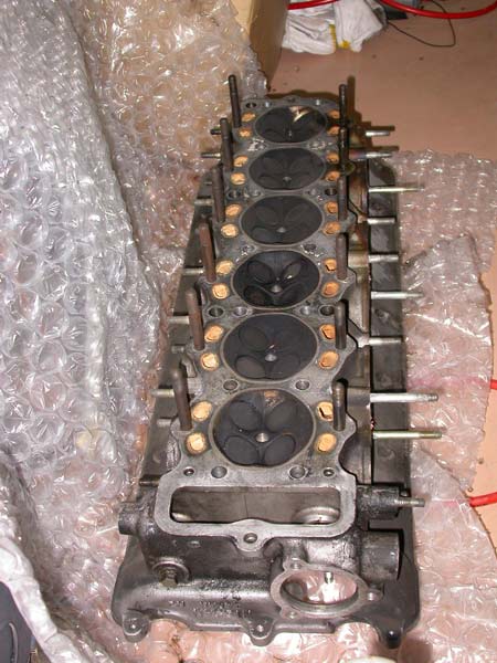

PS - Just in case you haven't seen the business side of an S20 head, here's a picture of mine which is awaiting rebuild at the moment:
https://www.classiczcars.com/topic/7583-heads/#findComment-47549
