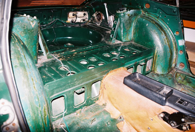

Has anyone got a picture that they can post showing where these plastic lids fit. I still can't see where they fit. Maybe they are only for the series 2 model.
I have vinyl liners under the hatch on my series 1. It looks stock as they are very old and are showing their age. They come out really easy as the contact adhesive is shot. Looks as though the design team lost interest under the hatches or too busy to get the series 1 out on time.
Digital camera is out this morning and I'll post some pictures of what mine looks like later today (if I can win the battle with the PC)

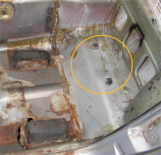

The plastic toolbox lids only fit the series 1 (read: one) Z's. They have a hinge that attaches with screws to the floor of the car behind the seats on the raised area (there should be brackets welded to the floor of the car) and then the two L-shaped brackets on the vertical wall behind the seats for the top of the toolboxes to be screwed into with a couple knurled knobs. If you have two lidded compartments on the luggage area floor just behind the seats, then you don't need the plastic toolboxes. I have attached a picture of the plastic toolbox floor brackets in my car behind the left hand drivers seat (circled). Note that my L-shaped bracket on the wall (see the black painted area) was removed by the previous owner.
hope this helps.
