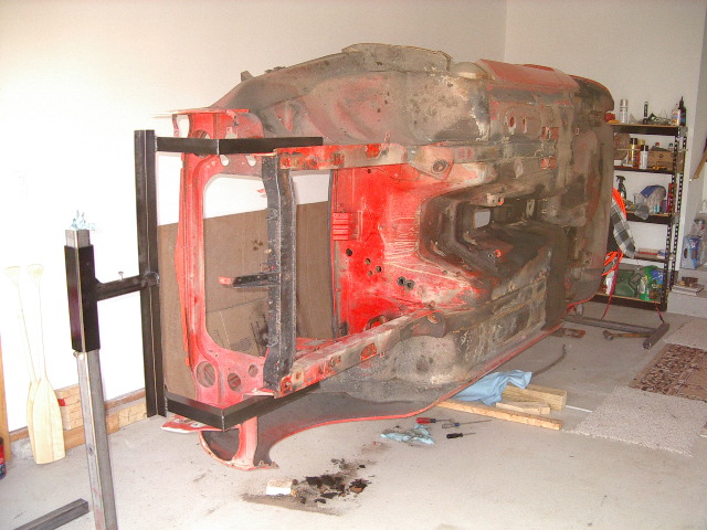

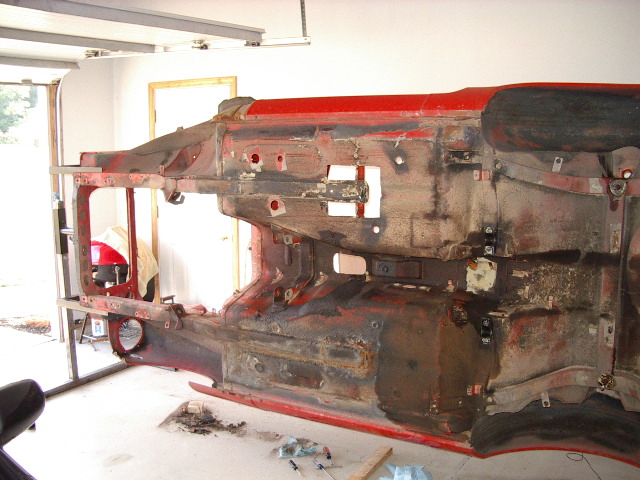

She's on the rotisserie.
I was going to start mine this weekend but I got to thinking that I need both floor pans (and then some) and the crossmember mounts rebuilt. I don't want to cut them out and chance the body distoring while it's in the air like that. There's only 2 months left to work before winter so I may have to wait until spring.
What kind of welder did you use? A guy down my street has every welder you can imagine and I was going to use one of those, but for $200 I'll buy my own.
Yea, the car is in pretty good shape. I got it in San Diego. So far the only rust is in the floor by the end of the frame rail. Part of the frame rail is gone too. I don't know but I think that those frame rails are rust magnets.
The steel I used was 2" square tubing .120" and I got the specs right here on this site. I did a search on rotisserie's and came up with a couple of different designs. I just took what I liked from each and put it into a design that I liked.
I got the welder at Harbor Freight. It's a gasless wire feed. I would have gone with the gas but I didn't have the budget (about 300 bucks more). I like it, it does require a little more cleaning though.
