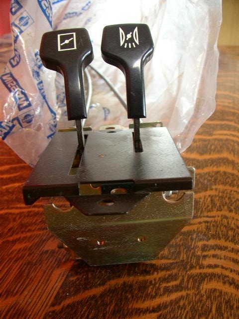

Great. Then at least we know that there is a part that was used in automatics that might work in a manual. Does it look like the attached pic that I found on the web?
mdbrandy,
That is the correct item, I just thought through the fingure control I use on start= both LEVERS up, turn the key, engine fires both LEVERS half down, engine stabilizes right LEVER all the way down set left lever for RPM warm up. So to that for my Z the levers are correctly positioned, maybe it would reverse with the driving position change for HLS body?
cheers
Steve :classic:
Nope. In my car, which has the choke and throttle (I'm just missing the knob and throttle cable), the choke is on the left and the throttle on the right. Just like the picture.
Thanks!
