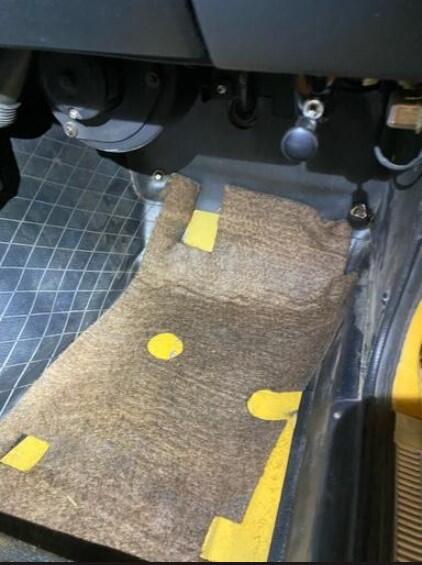

On 1/23/2022 at 1:09 AM, zed2 said:
I believe that jute section is wrongly positioned. It appears to be upside down and back-to-front, if that makes sense. That long oblong cutaway at the front is for the Japanese market seat mounts, whilst the more square cutouts at the rear are for the passenger footrest bar mounts.

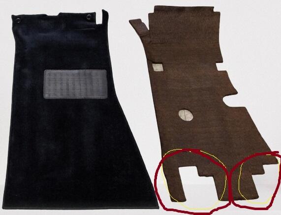

Are you aware of any JDM floorboard stamping that would necessitate the jute cutouts indicated by the red circles in the photo below?
Thanks,
Keith

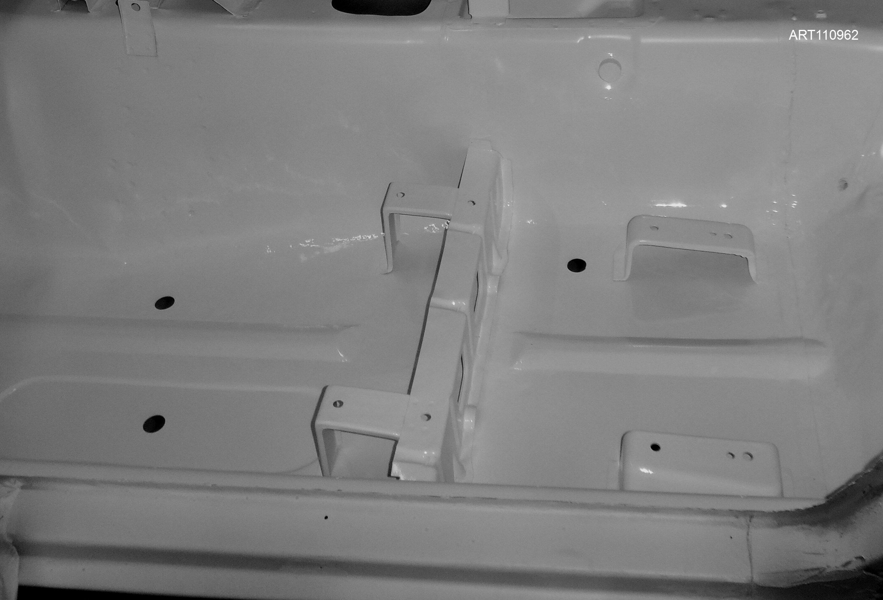

They look like they are to accommodate the Japanese market forward seat mounts.
Below photo shows left (passenger) side floor of Japanese market RHD car:

Do you agree with my thoughts on the cut-outs in the rear end of the jute being there to accommodate the Japanese market forward seat mounts (and hence 'universal' jute pattern)?
1 minute ago, HS30-H said:
Yes, I noticed the carpet section was LHD format but I was specifically addressing your question about the jute section next to it.
HS30-H,
I understand your observation.  I am a bit confused however, since the USDM Series 1 were shipped to the United States (US) without carpet and padding.  The carpet and padding were cut and installed in the US, therefore why would US fabricator make accommodations for Japanese market forward seat mounts?
(Unfortunately, I do not have access to "Japanese market forward seat mounts" to compare the measurements of the bracket locations and the cutouts.)
The mystery is not yet solved!
Thanks for your input!
Keith
Here is, perhaps, a reminder for us of the elasticity of the 'Series 1' term... I'm not a fan!
Wasn't it only the very first (whatever that means...) few HLS30Us that were shipped without carpets and ended up getting the locally made versions? I have a 4/70 HLS30U and it certainly had factory-fitted carpet when new.
The jute section in question looks like a factory piece to me (?). If it is, then I'd expect it to have - at least - the cut-outs for the possibility of a passenger foot rest bar in the same 'tits-on-a-bull' (pardon my French) way that the tar mat does on my 4/70 HLS30U. The cut-outs at the rear certainly look to be in the right place, and the right shape, to accommodate the Japanese market forward seat mounts. Plenty of other stuff on these cars is there only because they were designed with other variants in the mix, after all.

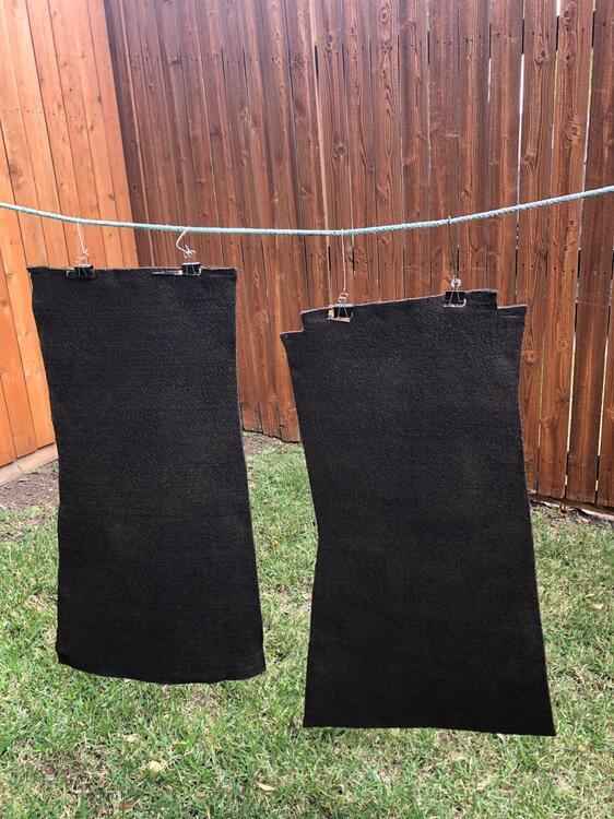

Prototype:
Natural color
Final color:
I have not yet trimmed the cutouts….I am still attempting to confirm the actual cutouts based on my 240Z production date.
The material I source is 39+/- 1" in width, currently I can purchase 10 yards, imported from overseas.  I then have to have the material color matched.  I then have to hang the material outside to reduce the fumes. The materials, chemicals, and labor for the two front mats shown above are approximately $450 all in (this is a set I plan to use).  As I have discovered on some samples, the color did not penetrate 100% of the material, leaving some of the original uncolored material evident.  Therefore, I may have to have the material color matched after cutting to pattern.
I have not tested the color for colorfastness, off-gassing in an enclosed vehicle, and water repellency or absorption.  Therefore, I consider any sample and my set a prototype.
At this juncture, it is not feasible to offer large pieces to others.  I want to get some samples to Z owners for their feedback.  Once I have confidence in the process and product I will make it available to the Z community.
Keith
