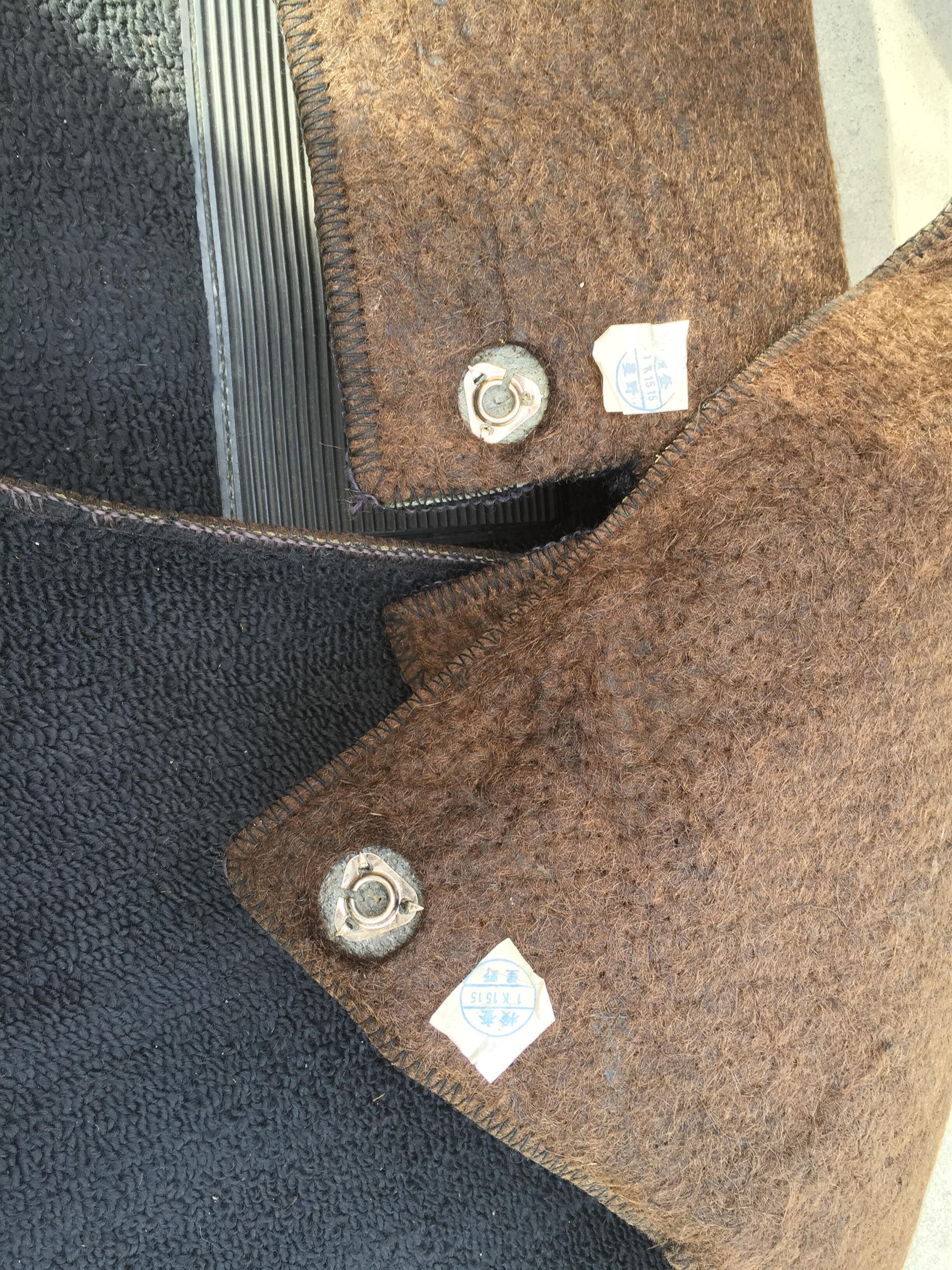

On 8/17/2022 at 3:27 PM, kats said:
Hi Keith, yes the jute is sewn to the carpet , looks like it is original , an inspection stamp has an inspector name “ Hoshino “ on it , 1 K 15  15 will mean 1971 November 15th , the last ‘15’ is still unknown.
This car has a set of 5 pieces carpet and 5 pieces of jute , all carpets have this inspection stamp at the back .
Yes I think so too , the heel pad looked to be the same as yours , interesting!
Kats

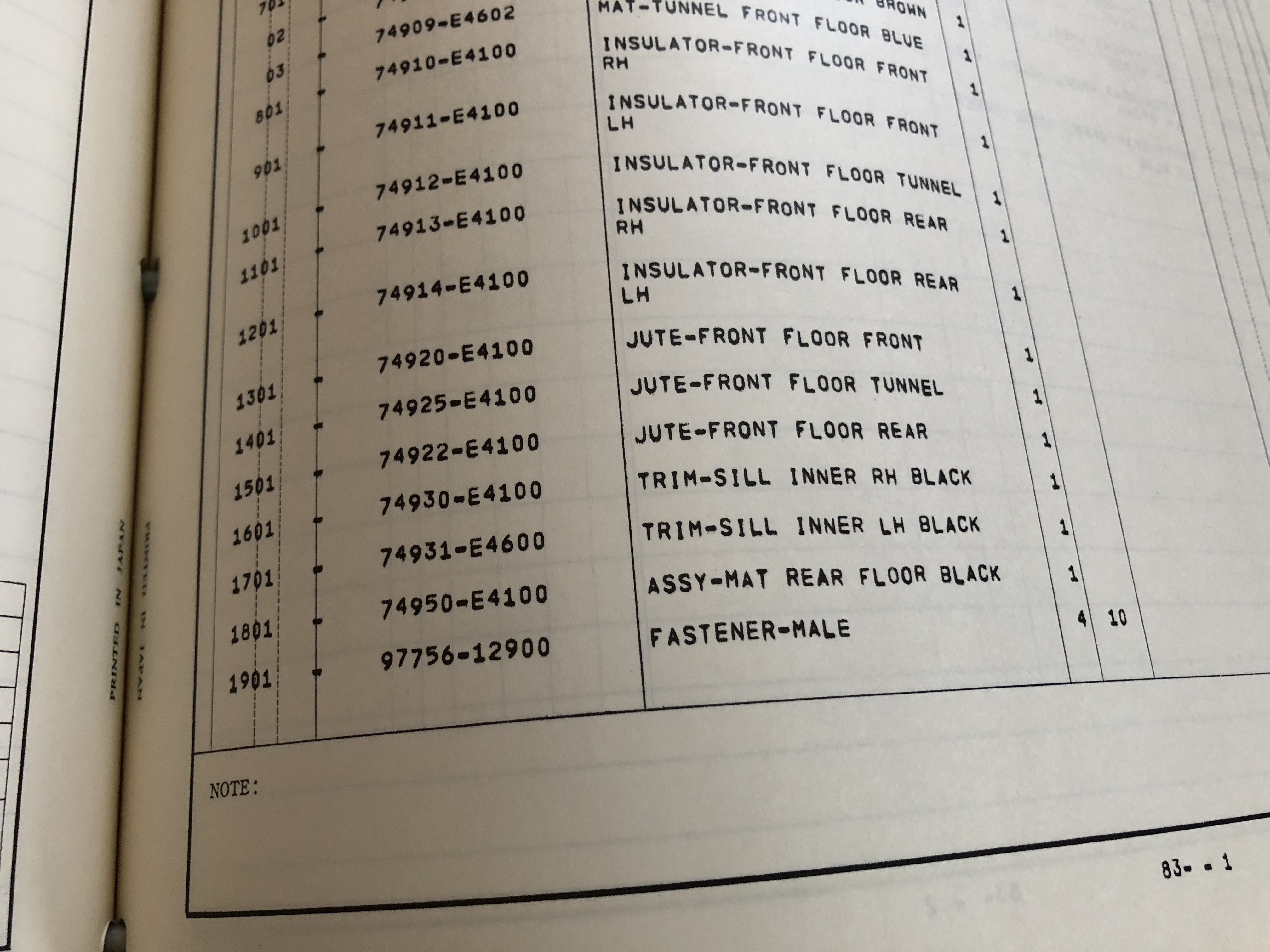

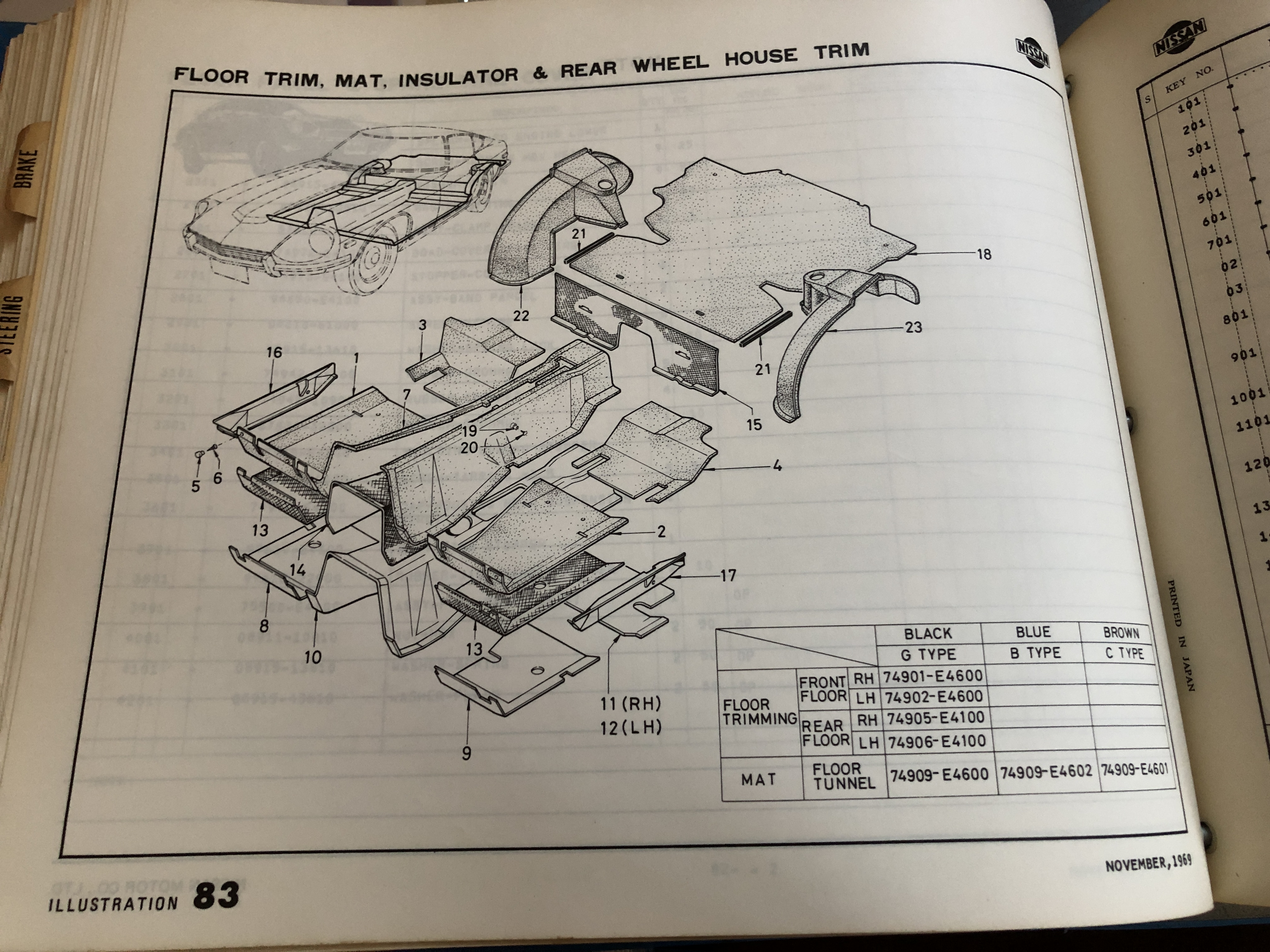

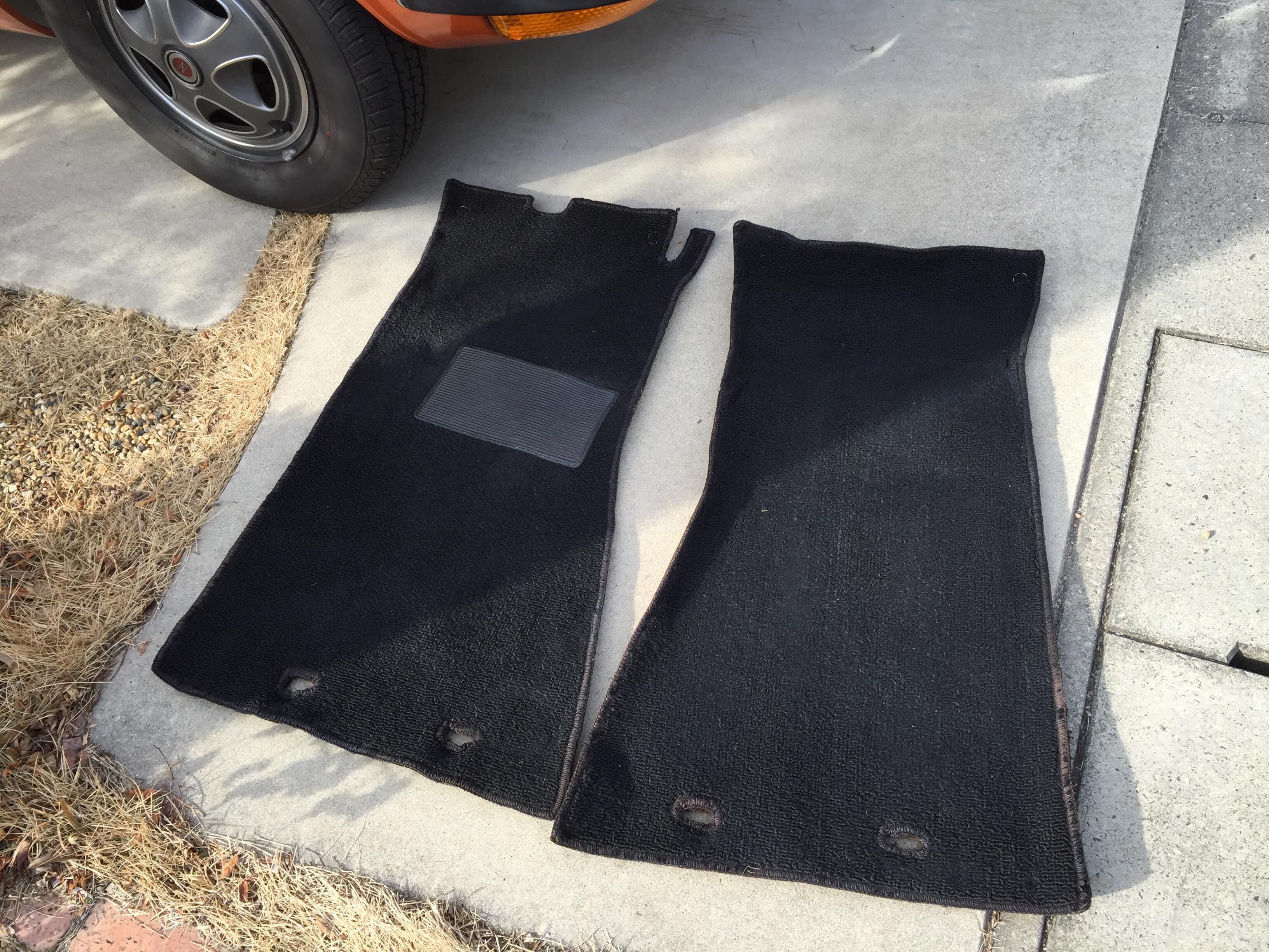

Hi Bart, Chris 26th-Z answered to your question, I didn’t know that story when I heard of it here classic Zcar club.
And carpeting is always one of my big interest. How did they look like? It is very difficult to find true original, difficult to see good condition originals in person.
What I am not clear about is the earliest carpets which were added at the port of entry (dealership ?) in the U.S.
Were the carpets made in U.S? Were they exactly the same to the ones which were applied later such as January or February?
E4601 is the first number for the carpets  for export model (LHD territory), was this number “E4601” for the carpets which was added at the port of entry in the U.S?
Or if Nissan would have started to apply new carpets for the export model around January or February etc, were they exactly the same ones for the ones applied to Japanese Fairlady Z series? And were they the ones which got the number E4601 for the first time?
 I confirmed my 12/1971 North American 240Z and 06/1972 Fairlady 240ZG have the same carpets which were made of the same materials.
But I still don’t get it, they have different parts number for each of them for the rear deck carpet which doesn’t seem to be any different. Very confused.
Kats

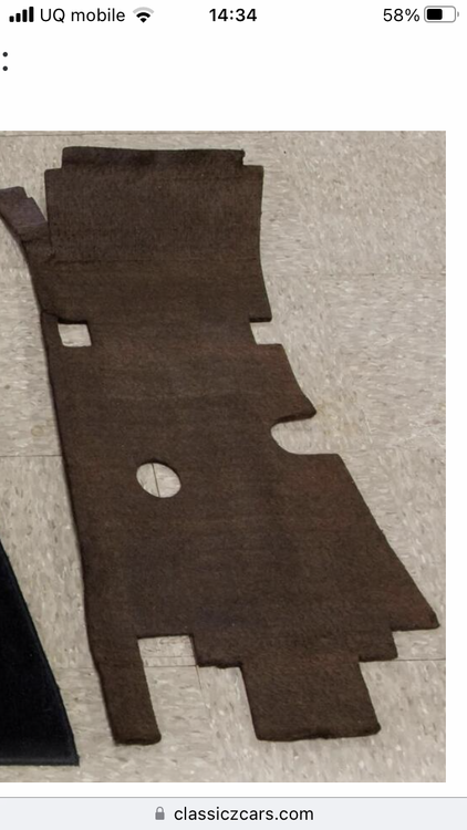

Hi Patcon,
I can say I am convinced about the jute for cars up to January or February 1971.
Our cars have only one jute for both sides of front floor, for any cars Japanese and all the other destinations. That is why there are cut outs for the seat mounts forward brackets to be utilized for all the destinations. And the shape is the one shown here from the Green BAT 240Z (04/1970).
My car HLS30-02146 (03/1970) still has the one on the right side. I can make a template for you Patcon (including rear floor and luggage floor) I will send you papers which I draw.
Easy homework for me!
Kats

That would be great!!

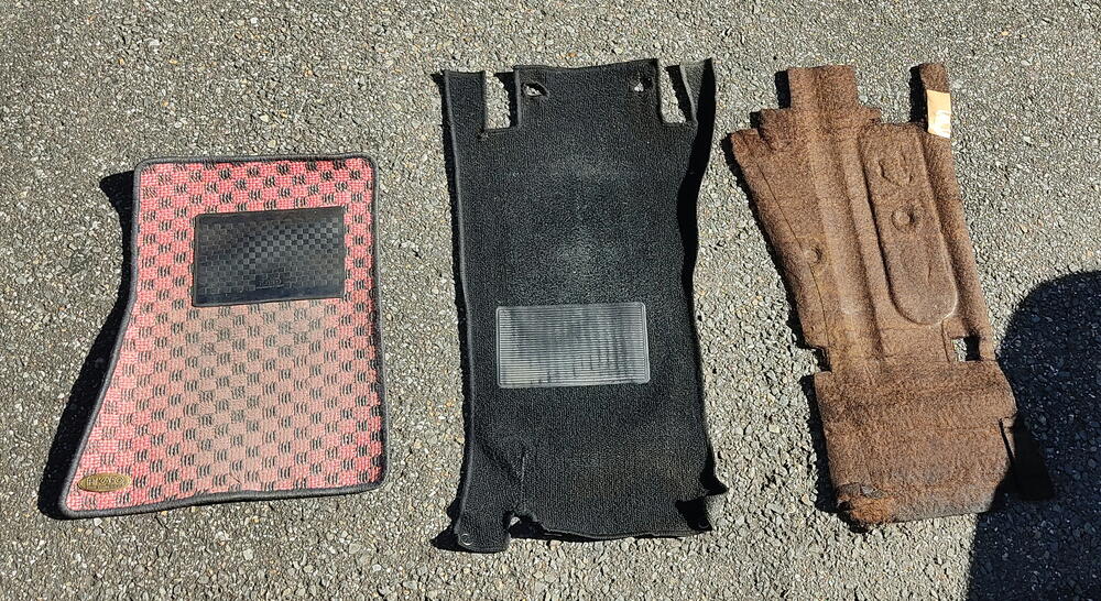

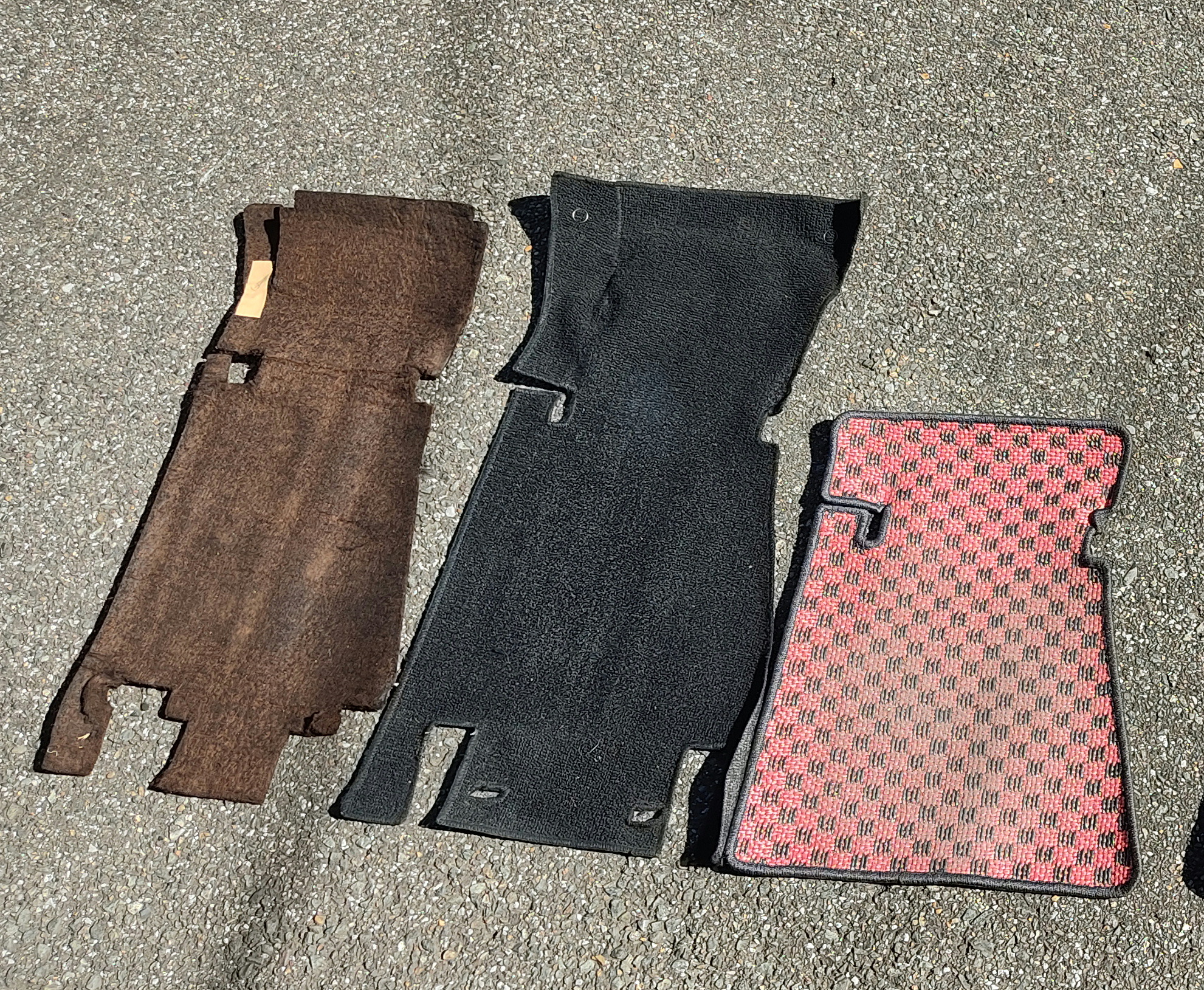

Hi Patcon, was your car made in November or December 1970?
If so, this jute is what your car would have.
The picture was taken from a December 1970 Z432 owned by Mr. Watanabe.
The car still has a set of jute and carpet seemed came with the car from the factory.
Now we can say at least on December 1970, the pattern of jute had already changed to the later one which can be seen on 1972 cars.
The difference between the two, the early one has cut outs for the drain plugs and the foot rest, and the seat mount brackets. The later one doesn’t have cut outs for the drain plugs.
Kats

Yes, my car was made 11/70

The early USDM cars did not come With carpet nor Jute underlay. To my knowledge, C&H cut these pieces using their proprietary patterns. The trimming of the cut outs for the drain plugs and the foot rest, and the seat mount brackets were at their discretion and may not have been consistently done.
