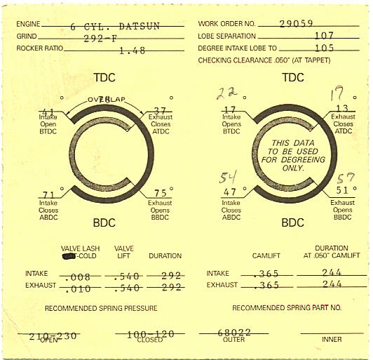

Does anyone have information on the Schnyder performance cams. It a 17033 performance cam from MSA.
Cant find the paper work that went with it and im trying to adjust the valves. Looking for the hot or cold setting.
Stock is .10 for intake and .12 for exhaust. Not sure if its the same as the stock settings.

That’s the information I needed.
I set them at .10 & .12 hot and what a difference. After every thing seated, about 1,500 miles on new engine the valves needed to be adjusted. It made a difference.
