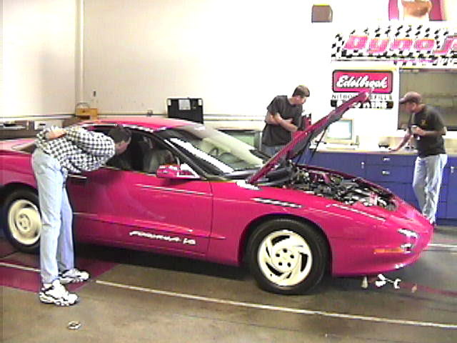

Ya know 240ZX, it's the red color that got you stopped. Out of all the colors I have owned Red says 2 things Light'em up & Write'em up! as a matter of fact I have a compulsive disorder, and polishing cars is away to get in that zone. I once had a sand rail that was all polished alum. and it takes alot of work keeping it nice, a few 1st place off-road car shows is the pay off. Now it is just nice to have a clean ride. Our Z is clean for a track car but they get hammered, chipped and dirty easy in track traffic.
This is a pic of my daily driver, (sorry not a Z but it is RED sled!) I ordered it in 1993 to my taste, 10 yrs. & still looks like new. Just can't stop tweakin under the hood! That is a main reason for getting the Z, take the race to the track. It's working no more tickets!
