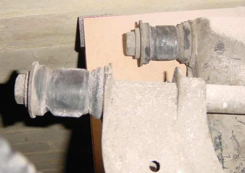

OK, i dug out my transverse links with rubber bushes which came with the car still fitted, and to my untrained eye, they still look to be in good shape. same goes with the spindle pin bushes.
So basically my question would be, if a rubber bush looks to be ok, should it be ok ? :stupid:
If I were to re use them, should I grease them or anything?

If you do reuse them, definitely clean them up and regrease them.....especially the spindle spin itself.
Edit: Might take some pics of the 30 year old rubber bushes I just pulled out of mine....that'll show you what you DON'T want them to look like. :D

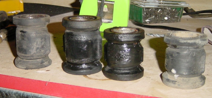

Alright, aside from being dirty, can anyone point out the major flaws in those rubber bushes and general flaws to look out for when replacing them?
I can see dags hanging off them, but to me that could be the casting marks just as easily as it could be wear/damage?
(thanks for the pics by the way)
They don't look too bad to me, possibly reuseable if you are a tight arse :geek: Look also at the bearing surface on the suspension arm, if it is in good condition then that shows that the wlole lot has not been moving around loose.
Important to reinstal them correctly.

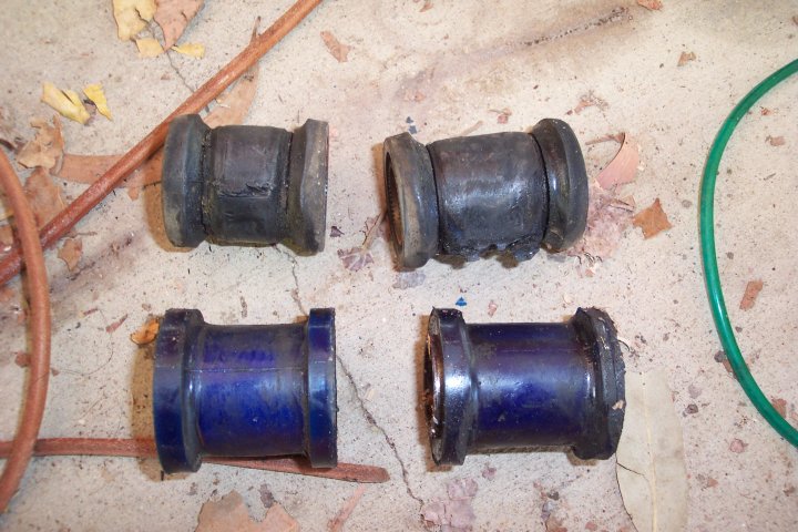

Aside from the brick dust from the drilling i was doing above, i think these bushes are salvagable ?
I took the bushes to a suspension place for advice and they recommended replacement, but obviously they would have a vested interest and they are calling me tomorrow with a quote on full nolathane bushes.
I went to Nissan as well for a quote and for all 8 rear control arm bushes we are looking at $273.00AUD :eek:
