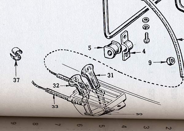

I think you can show us the picture of choke and throttle knobs in the japanese "fairlady Z" parts catalog.
I think the drawing touch is quite different,right?fairlady Z's parts catalog show the round type knobs,I think.

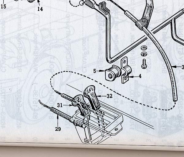

OK - I just had a look at four different references for this, and none of them have good clear illustrations. Sorry.
However, its clear that there were three different part numbers for CHOKE knobs and two different part numbers for THROTTLE knobs up to 1972. That shows that the shapes changed, I would think?
Here's the illustration from the 1970 Parts List ( Japanese market ). The numbers quoted are the same for the L-series engined and S20-engined versions:

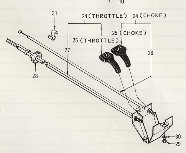

Here's an explanation of the part numbers and their superceding numbers. Its from the Euro export market parts list:
*18415-E4100 KNOB-CHOKE manual & automatic ( up to 01-70 ).
*18415-E4101 KNOB-CHOKE manual & automatic ( 02-70 to 08-71 ).
*18415-E8700 KNOB-CHOK ( sic ) manual & automatic ( 09-71 up ).
*18515-E4100 KNOB-THROTTLE manual ( up to 01-70 ).
*18515-E4101 KNOB-THROTTLE manual ( 02-70 to 08-71 ).
So, the very earliest knobs were very possibly a more rounded shape than they later became.
