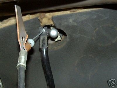

One question for those of you that are using these. I understand that the cable attaches to the back of the gas pedal. I am wondering if it needs to be attached by a bracket or something to the firewall?
Sweet! Yours is better than mine, since I bought one with square knobs! Anyway, on the firewall, there should be a pinch bracket to connect the cable through. I posted a pic of mine in another thread:

Look about half way down the second page of the thread, and I have a picture posted of the pinch bracket.

Thanks Mark. I figured that there must be some sort of bracket or clip to hold that cable in place. Hopefully that bracket is in my Z blt, 6/70.

You got a very nice choke and throttle unit.Have you installed them already?In my case I did installed it by myself and it was very easy.Just hook the cable end to the throttle pedal and poped the plastic gromett into the stopper.
That plastic gromett is a small part but it is a very important thing for the functioning.

Is the plastic gromett you are referring to, theone at theend of the throttle cable that shows in my picture?

Yes the plastic gromett is the one witch is shown on your post here.I do not know why,I saw many of them were broken or almost fallen off.

Here is an interesting picture I just pulled off eBay concerning the installation of the hand throttle. Supposedly, all series one cars have this metal bracket welded up underneath the dash at the firewall.
