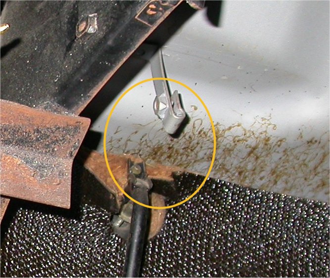

Here is an interesting picture I just pulled off eBay concerning the installation of the hand throttle. Supposedly, all series one cars have this metal bracket welded up underneath the dash at the firewall.
I saw that picture, and I don't believe that it is correct. I believe that the plastic grommet actually clips into the pedal bracket. then, the metal cylinder that covers the end of the cable is clamped into that bracket, and there should be a bolt pulling the clamp together. I had posted the attached picture long ago in another thread, but you can still see the plastic grommet in my pedal bracket. The metal "ball" on the end of the cable then pulls against the plastic grommet attached to the pedal bracket. When you release the hand throttle, the cable slides through the plastic gromment, and the metal ball hangs loose. You can then press on the accelerator and the plastic gromment (attached to the pedal) slides along the cable without pulling it.
Sorry to get into this discussion late, but I am a new member to this site. I also have a choke/throttle set-up on my car which was installed a few years back. The throttle was never hooked up until just recently after I saw the photo on eBAy. You are correct in that it doesn't work the way shown. When I purchased this set up, it came with the more square knobs. Since then, I've had to replace the throttle knob and obtained the more rounded one. So now my knobs are mismatched. Also I found the screw insertion is on the opposite side. The rounded one is on the left side (inside) where the square one is on the right side (outside). Is this consistant with everyone elses?
