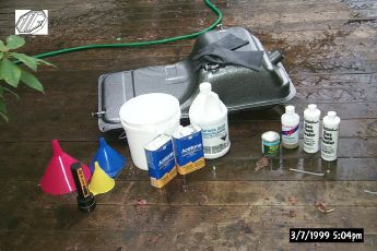

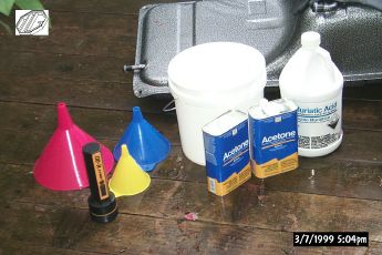

I refurbished my own gas tank. I even purchased the entire kit from Eastwood, but, decided against putting in the sealer.
I purchased all of the other ingredients (acetone, etc), but, decided not to pour in the sealer at the last minute.
Here are a few picts of the stuff as I did the work....
This is a shot of all my supplies and the tank. Notice the nicely powder-coated tank and the rubber gloves. Be careful when you take on a job like this!! Nasty, nasty, nasty chemicals....

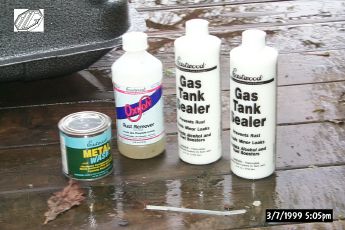

https://www.classiczcars.com/topic/908-gas-tank/#findComment-3108
So, here we have the metal wash, rust remover and the sealer. Again, after taking all of these steps, I decided NOT to pour in the sealer because it looked so pretty inside!
I also heard that the sealer comes apart eventually over the years and can plug up your fuel system.
