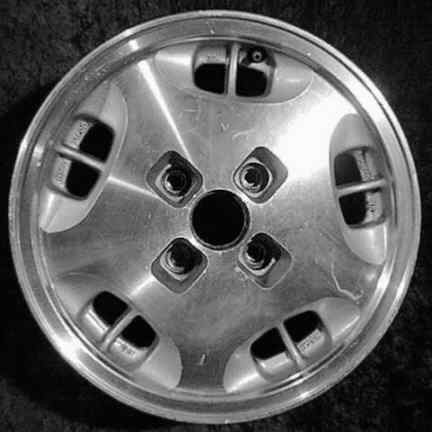

In Australia as an insurance assessor and Z card horder I have been horrified at the motly lot of wheel combinations I have found on the various Z cars I have rescued from New South Wales. A Mark 2 had four stud 1984 300Z wheels (pic enclosed) which looked ok but when I transfered the wheels to a second car just to hold the front end up, I could not move the car as the wheels were locked up on the front struts, on further examination I found I had left the spacer plates!! behind on the 82 wrecker. To think this car was hacked around Sydney in traffic in this condition, let me tell you what the coroner would say at an inquest when the prosecuter told him that 300 zx wheels were swapped to another model car and held on by 5 thread turns of the wheel nuts. If you were still alive and anyone else was injured you would probably go to jail. Read non disclosure clauses on your insurance policy and you might get a shock. If you fit non standard wheels in Australia you have to notify and disclose the type but the conversion has to be legal and be sound engineering. Fitting a ZX wheel with spacers leaves too little thread remaining to safely hold the wheel on under collision conditions.
