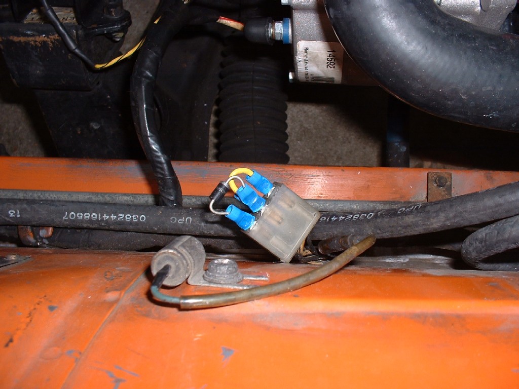

I read the article on Zhome, but the description isn't really that great. I'm more of a visual person too so pictures would have helped (the ones on Zcarcreations.com are kinda confusing). I know I need to cut off the plug coming from the voltage regulator and wire it up to some other wires at the alternator, but I'm not sure if I'm supposed to wire it back into the harness alternator connections or directly to the alternator! Maybe I'm missing something. Anyway, I'm doing this because since I put in an electric fan and upgraded my headlights, everything goes dim at idle at night. Since the Z's charging system was made to accomodate just the stock system I figure I should upgrade.

There is an area of ambiguity in the article on ZHome (also on our site as well) regarding where and how to install the diode. The installation that I have seen used the connector from the old Voltage regulator to install the diode. The diode was placed between pins on the former V Reg connector that corresponded to the WHT w/ BLK and BLK w/ WHT wires on the Car Harness. this avioded chopping into the OEM harness to make the connections. IOW, the car could easily be converted back to External Reg Alternator.
Now, I haven't done the conversion, I'm just reporting what I saw on a friends car, so confirm for yourself the locations of the described wires at the V Reg connector and wire the plug accordingly.

Have done this conversion on both cars. Can reccomend it as it doesn't chop up the cable, used alternator from a 280zx, plugs fitted directly into the unit without modificiation, requiring only the removal of the VR.
You don't need to cut anything, all the jumpering can be done through the harnesss connector.
The diode is quite important though to prevent the field charge from feeding back through the ignition thus preventing you from turning the car off.
