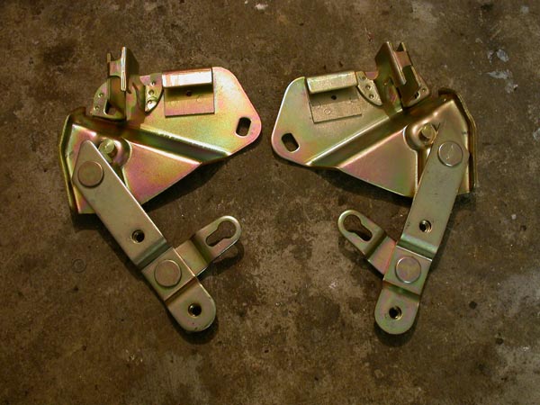

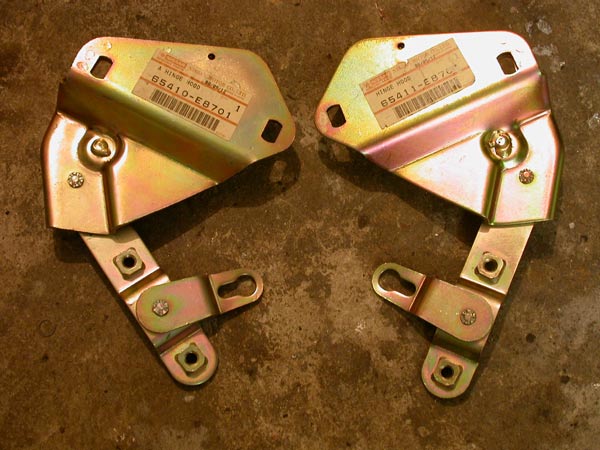

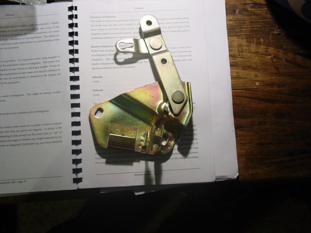

Guys what measurements do you want? I can take some measurements and stuff, but until I can find a normal hinge (in daylight) I wond know exactly whats different. From memory I think it would be alot of work, may be better off starting from scratch? I will work out some measurements.
Cheers Chris

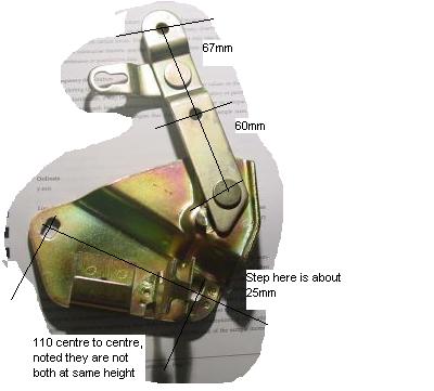

Hi Chris,
That's excellent thankyou.
I asume the RHS hinge would be a true mirror of the LHS picture your sent us. Correct?
I should be able to manufacture these based on your picture.
The bolt holes distance would be the scale reference.
Could you measure the holes center to center please?
Am I correct in saying, that these hinges only mounts with 2 bolts, not 3 like the standard ones?
Would you have a picture of the back side and one showing the profile as well, by any chance?

Thanks for all the help.
I have now manufactured suitable hinges for my G-nose.
They look nothing like stock, but the geometry is correct and they are very light.
The secret lies in that the pivoting point is actually excactly where the third top bolt, on the standard hinges, mount.
I cannot believe the hinges I was sold years ago from a reputable Z shop was so wrong.
If anybody else need more info let me know.
Michael

I work Parts at Nissan, and those were Genuine Nissan parts. I'm going to check and see if there are any remaining in the States tomorrow, and post the price I could give you all. Awesome that you made your own, though. Just trying to pitch in any way I can!!!
