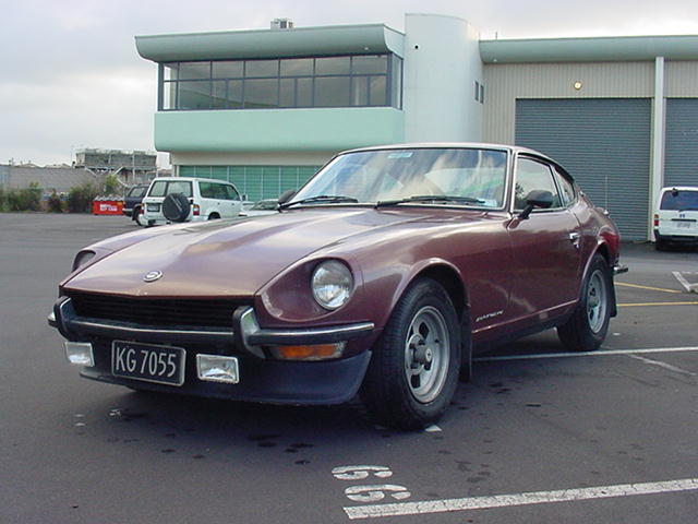

Those links made good reading. My 71 has a front dam fitted and factory rear spoiler. I was thinking of removing the rear spoiler but on reading those pages, I might as well keep it on there.
I have seen another Zed with the same front dam as is on mine. Mine was imported to NZ from Australia and I'm wondering if these dams were fitted in Japan or in Australia.
Here's a early pic
