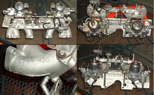

I'd like to see a good diagram or photo of the 240Z early SUs, balance tube and linkage, as well as where all the hoses, throttle control, etc. link up. I've gone to that microfisch site and the diagrams are kind of hard to read.
I have my own Microfiche CD I need to check and see if the diagrams are better. Once they get past the carburetor removal, re-build and re-install most of the aftermarket manuels just don't go into detail about the balance tube and connections, especially if the book is trying to cover 240Z, 260Z and 280Z IMHO.
I've attached a picture of my 70-71 SUs with the N36 intake from a 260Z. I need to go to the narrower spacer to get the washers, lock washers and nuts to fit properly for the carb attachment. Where can you find the thing on the balance tube that I believe controls the rate of throttle return or deceleration and what's it called.
Thanks for any help you can give.
Gary
