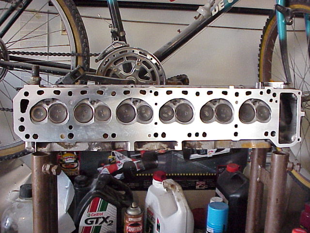

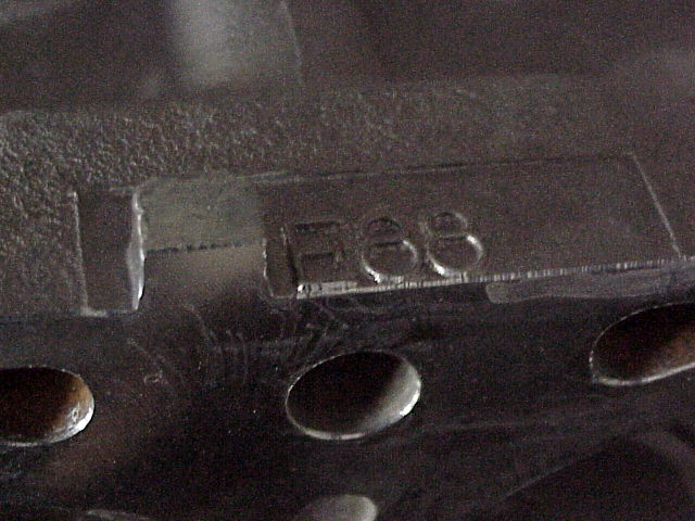

I'm pretty sure the earlier cast E88 off the Z series had the letters E88 stamped larger than what you'd find on later E88 heads off the R30 Skylines.
I think there may be a difference in combustion chamber size or valves.
Check the attached pics, this E88 is off R30 Skyline and stamped smaller than the Z series; this head has 42mm inlet valves and is 41cc standard. I shaved this .030" and fit onto my dished N42 block, got around 9.5 C/R now. Unless you're after a track motor the 42 vs 44 valves aren't a problem.
You may find the earlier Z series E88 is larger displacement head, I believe around the 44cc mark.
Just some food for thought, cheers....
