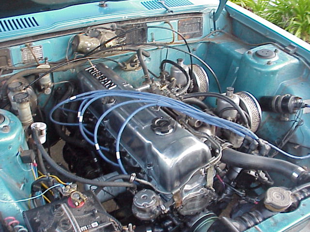

Almost. The manifold will bolt straight on (once you pry off the old one) - the only problems arise when it comes to accelerator and choke linkages. For the accelerator, you can mount the bracket on the firewall at a different angle (it seems as though the bracket and holes in the firewall were made with this in mind, as you dont have to fabricate or drill anything to change the position of hte bracket), and then it should fit fine. I had my choke fitted when the car was getting some other work done, you'll need a couple of cables and patience getting it hooked up on the inside of teh car, but it should be easy enough...
This is with dual round-tops, from a 240Z...

The 2000GT-X came with the same dual carb setup as the 240Z so theoretically it should essentially be a bolt-up job.
