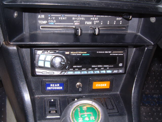

I am very curious about this myself because my center console is in near perfect shape, but the previous owner(my dad) installed an aftermarket stereo, and I would like to put the orginal back in. Unfortunately, ther is a small hole where the antenna switch is. If I do the swap, the hole must be filled.
Yes, please. Any thoughts on this subject would be great. C'mon, for sake of Djacey and I; i am pouting over here. Someone must have done this before. If not, where can I get a cheap and perfect center console for a 260z with manual trans.
P.S. The old Hitachi is begging to be reunited once again. It is sitted in an unwelcoming Alpine box in my garage as we speak.
P.P.S. Forgive me for the dust that plagues the nooks and crannies.
Thanks,
Ben

V12 Horse, Your easiest fix is to replace the switch with another red or yellow indicator or black push button switch with black securing ring that will fit the hole. I assume it is just round under that metal plate. Radio shack will have it. It doesn't have to have a function. I once wired lights under the dash that lit the floor areas as 240s dont have those. VERY few people will know its not factory. Make it flash when the car is off and some will think its an alarm!
