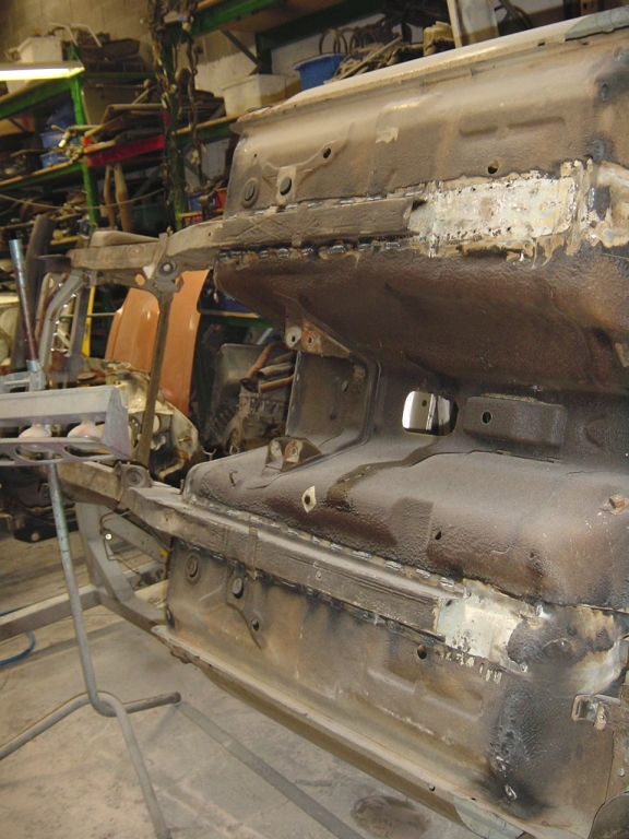

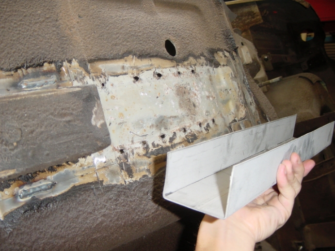

I have decided to shy away from a cage so hopefully the seam welding, rails extended to the rear and maybe some strut tower braces will be the next best thing as far as flex is concerned.
Here is another pic of the fabricated rail extension, obviously not finished yet
I had my shell stitch welded when it was restored & the plastic interior panel still creak when going around corners!

Originally posted by drunkenmaster
Im not sure what you mean?
IMHO your extensions are a good idea as is the seam welding. The extensions weigh very little and the weight is low as in center of gravity.
A mates car was seam welded and has a bolt in half cage fitted. And its plastic is quiet, unlike mine which is now getting the half cage treatment too.
