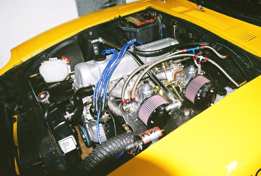

I currently have a Holley 4 barrel setup on my 73 240z. I am selling my holley and going to go with some su's. Is it okay to use my n33 manifolds? Also, what should be blocked and/or setup as far as the emission control stuff. Anyone have any pictures of a properly setup su carb install? Also, do you guys think the ztherapy carbs are worth the money?
https://www.classiczcars.com/topic/9910-tech-notes-for-su-carb-setup/
Well, what is value worth? To me they have alot of value because I included the support from ZTherapy, the warranty, good looks of the SUs, Video included, the available mods they did for me, the phone time, I tapped into their experience and knowledge of Z-racing, oh and their new stickers are well worth SU-money!
